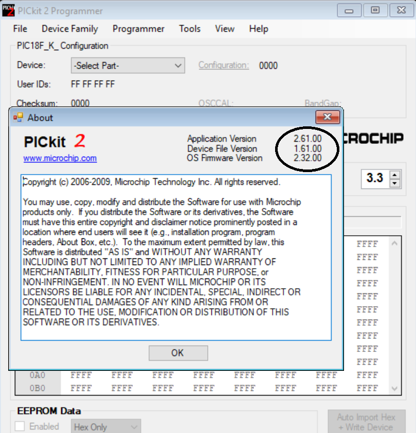

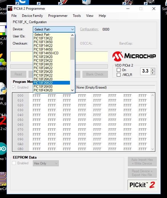

    2,643
    Default Re: How do I discern Maidenhead Locator from GPS lat long info.
    your pk2 device list file is out of date, there are many more k22 chips supported .
  29. #109
    Oct 2010
    413
    ooops i dint know.
    i tried many times to check if there is a newer version and didnt find any that 2.61 with the devicefile 1.61.
    I will check again. thanks for the update really i didnt know it.
  30. #110

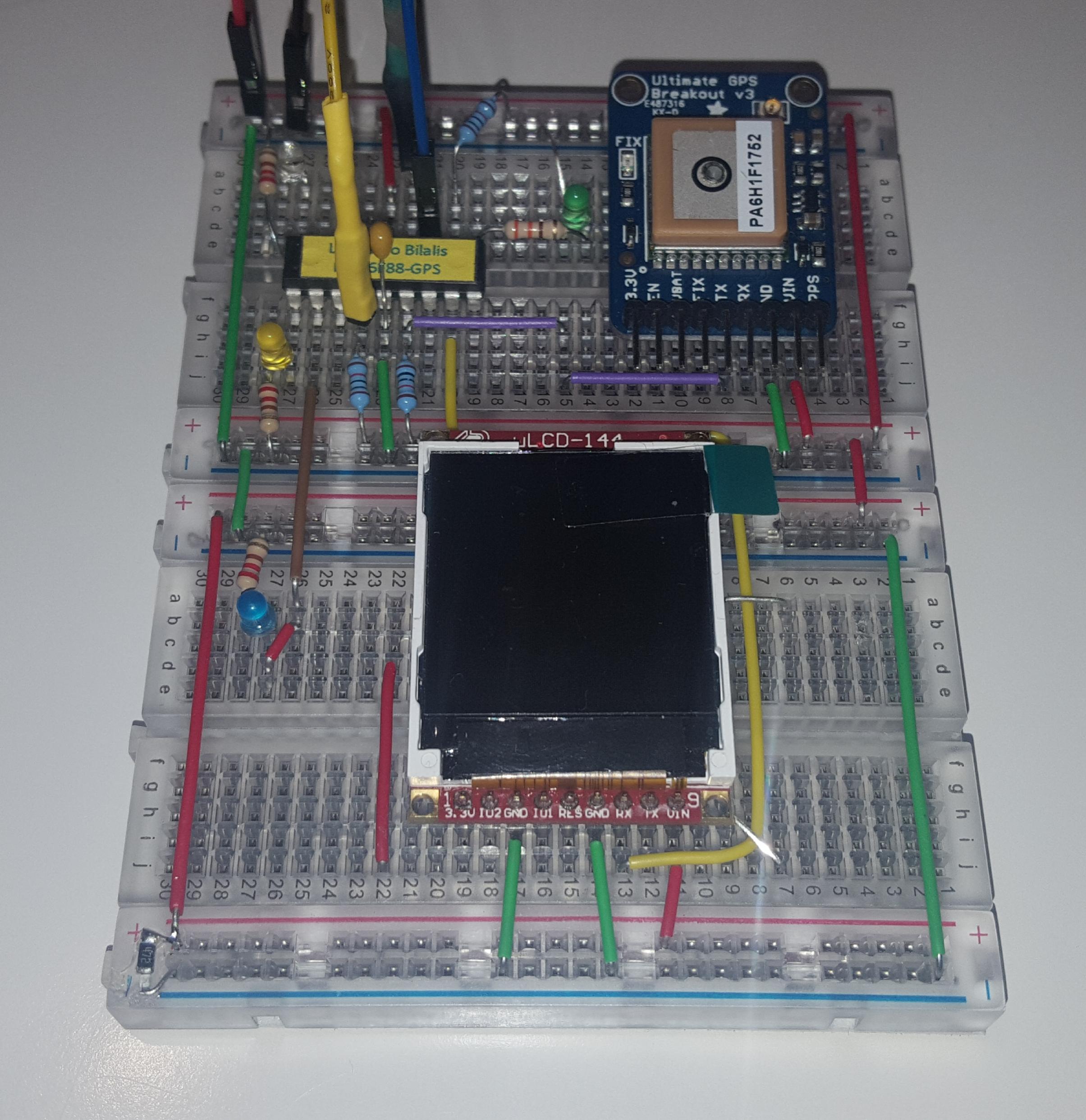

    2. As far as the pic16f88 is limited in ram i need to step up and use a better microcontroller. Im Looking at the PIC18F4550 or PIC18F2550.
    3.The project as i have it in mind need to have an SD in order to store the Data from GPS Nmea.
    I found out that only a microcontroller with 48mhz supports something like that. Apart from that i have a question.
    May i use the same speed for All the peripherals SD, Ulcd, GPS? Or do i need to specify different one for each module?
    May i use 48mhz for processor speed and use low speed baudrate to communicate for Serial?
    Could You help me and clarity what i need for each GPS, SD, Ulcd?
    So i need to communicate Serial with GPS module and then i need to store the raw Nmea Data to SD and display what i need from the Nmea protocols to display.

    The file "PK2Devicefile.dat" have not edited the microcontroller type. Use DEVICE EDITOR software from here https://sites.google.com/site/pk2devicefileeditor/ and here is the Device ID PIC's
    Really thanks a lot for your kind help. I would keep the dat. file as it is for now. I'm a bit afraid to play with that .dat file at the moment. If i need to use a PIC that is not on the pickit2 list, then i will give it a try.

    Apart from that i have found the attached file for the PICKIT2. Do you have any reference on that?

    Ok i have right now:
    1. TX port which is connected to ulcd. Baudrate : 38400
    Example code:
    pause 2000
    serout2 LCD,6,[$55]      ' uOLED Initialize this is the 'U' character of autoband rate to LCD
    serout2 LCD,6,[$56,$01]  ' this is the Version info
    serout2 LCD,6,[$45]      ' clear the lcd
    2. RX port from GPS module. Baudrate : 9600
    Example code:
    ;serin2  gps_tx,84,timeout,lostcable,[wait("$GNRMC"),_          ;we wait for $GNRMC
    The GPS at the moment is locked at 9600. Via the serial terminal GPS software i set it to 19200 and accepts the command. But only for the time the module is connected to the power. When we disconnect the power from GPS, the default commands are set.
    I dont mind for that right now as i found out that i can communicate with PIC at 19200 with GPS and receive the commands on the display.
    The setting for the Clock Speed is 8Mhz.
    Now if i increase the speed of the baudrate with GPS and goes up to 38400 then i cannot display anything.
    I did an experiment and added an external Crystal of 16 Mhz. For my surprise values presented on the display.
    I have a question now. something i dont like with the following code:
    @ ERRORLEVEL -306 ; this command prevents the compiler to give you a notice of
                      ; crossing page boundary - make sure bits are set
        __config _CONFIG1, _HS_OSC & _WDT_OFF & _LVP_OFF & _CP_OFF
    Include "MODEDEFS.BAS"
    DEFINE OSC 8
    OSCCON=%01110000     '8 Mhz
    Why should i need to add both of the lines?
    DEFINE OSC 8
    In case i remove any of these, it compiles ok, but program is not working.
    I need to specify that this is an internal OSC, but above in the configuration bits i have put _HS_OSC (if i remember that must be set from the manual)
    Is it right?
    thanks a lot for your help once again.
