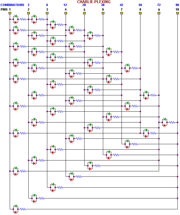

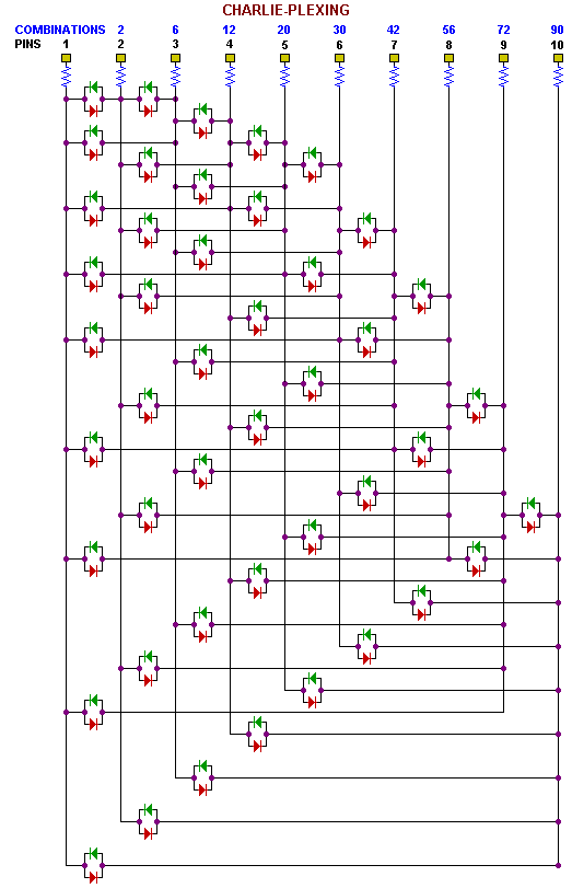

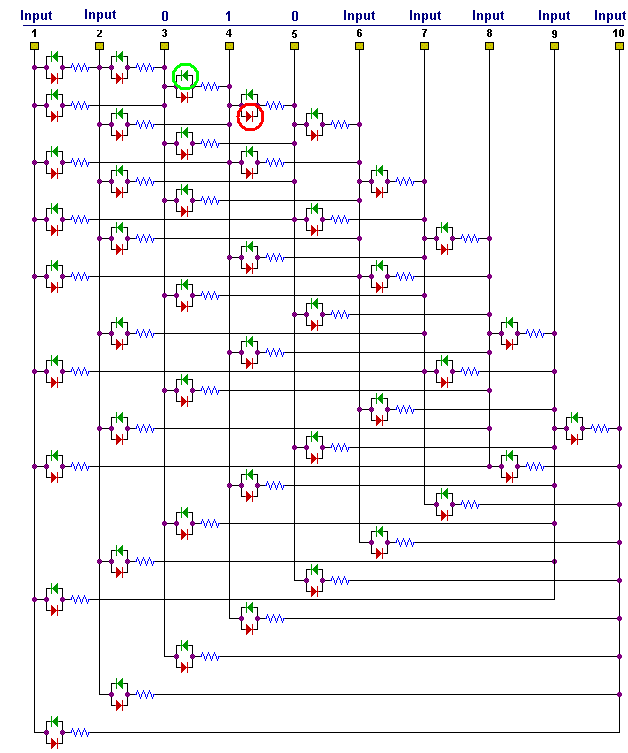

    The need to control a lot of LEDs arose in my residential alarm project, the most efficient I could google was charlie-plexing. I thought I'd share a chart showing combinations:
    EDIT: MUST USE 1 RESISTOR PER PIN
    Reference: http://ww1.microchip.com/downloads/e...Doc/40040b.pdf

    Hi Robert - a couple questions / thoughts....
    I think you have too many resistors. With the original Charlie-plexing, there should be one current limiter per pin, not per diode, since some combinations rely on the forward volt drop of a diode to keep two others from coming on. I think what you did will work, but once you get beyond 3 pins, you may start having different intensities of LEDs. It would certainly save you some components to go per pin rather than per LED pair.
    Do the red and green diodes have the same volt drop? Green is usually about double red, so there will be still more challenges. Is it your intent that something is green or red, but never off unless broken? I think that might be difficult to do too. The array will need to be constantly scanned if more than one led should be on at any given time. But you'll want to do that to save power, anyway.
    Have you done a big truth table to see what happens for each combination? You'll need that to write the code anyway, but it might save you a lot of work. I don't think this is something that can be tested in a simulator easily since it depends on analogue effects.
    Anyway, very cool approach if you can work around those limitations!

    Quote Originally Posted by Charlie View Post
    Many LEDs on the same pin may be on, but only a single LED per pair can be lit.
    The tri-state properties of a pin control which LED is lit, not forward voltage drop. See Tip #2 in the Microchip PDF.
    LED intensity is not supposed to vary depending on active LEDs.
    Probably not, the LEDs I have in stock do not have identical properties. But they are close enough for personal use. I am compensating by using different light intensities; ie: I have varying intensities of LEDs for the same colour. Bulk purchases so I don't have specs.
    I don't understand.
    Yes, definitely scanning to save current.
    Next on my TO-DO list.

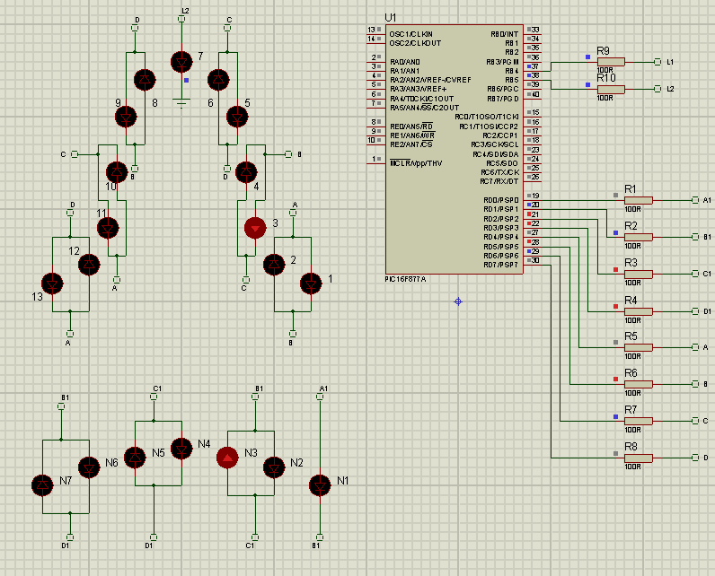

    Default Re: Charlie-plexing
    Here one I made earlier
    Actually simulated, it's the display of a tidal state indicator that one day I'll get round to building. The Xylon effect is just to test all bits with the two elements separate.
    George
    N2 does work, just a slightly dodgy GIF

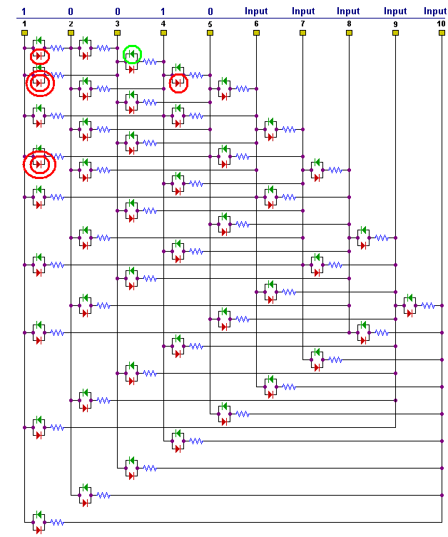

    Charlie, about the red-or-green-or-broken question. I can light the red, green or nothing at all if I wish (which is possible in this application).
    I am powering only one pin at a time. Due to the interconnections on the matrix, applying power to more than one pin will have undesired results.
    Pass 1:
    "1" on pin 1, "0" on pin 2, Input remaining pins lights the top left red LED.
    Pass 2:
    "1" on pin 4, "0" on pin 3, Input remaining pins lights the top green LED between pins 3 and 4.
    But...
    Pass 3:
    "1" on pin 4, "0" on pin 3, Input remaining pins lights the top left red LED and the top green LED between pins 3 and 4,
    but it also lights
    a red LED between pins 1 and 3 and
    a green LED between pins 4 and 2
    since those circuits are also completed unintentionally.

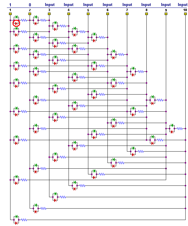

    I can power pin 1:
    Name:  CharliePlex pin 1.GIF
    I can power pin 4:
    Name:  CharliePlex pin 4.GIF
    But I can't do the same thing at the same time, two unwanted LEDs come on:
    Name:  CharliePlex pins 1 and 4.GIF
    Edit: I just noticed I missed another unwanted LED between pins 4 and 2.
    I'll probably use a dedicated 18F24K22 running at 64MHz to manage the LEDs. I have to test, but blinking each LED individually might give enough persistence of vision (50 Hz or so).
    I was initially planning on powering all LEDs active on one pin, but that might complicate things beyond my limitted abilities. I like to keep things simple.
    I might also manage a simple keypad, not sure yet. I have enough pins, but tests will show how much the PIC can manage and still give satisfactory visual effects.

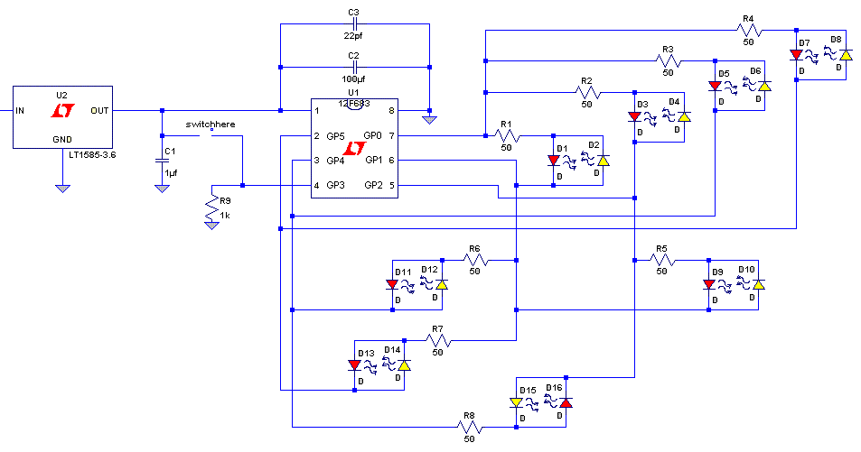

    Some neat stuff I forgot that I found several years ago on Charlie-plexing.

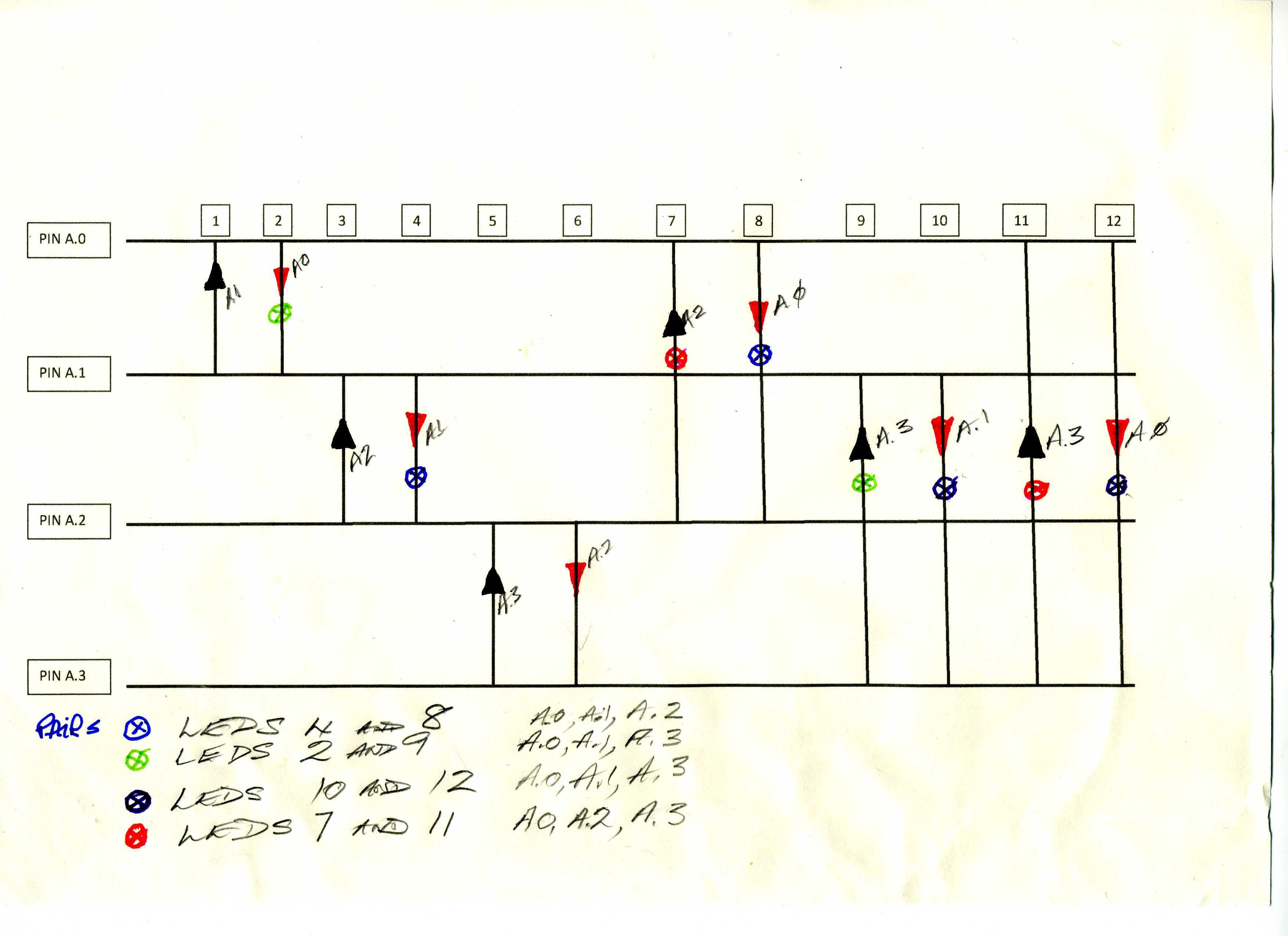

    Name:  Multiplex pins schematic.GIF
    Editted to add some colour, original was black on light gray background.
    I wish I could give a link and credit, but I can't find anything on google for this now (been looking for over an hour).
    Last edited by Demon; - 14th December 2014 at 21:42. Reason: Added code instead of PDF

    Only one LED will be bright enough to be visible even though multiple paths are active at the same time, because the shortest path is the only one with enough current. All the other undesired paths share the same current; not enough to make an LED glow.
    Cycling through the 56 LEDs on the 8 pins in the post above, a LED does not have enough current 7 out of 8 times:
    From Step 4:
    OK, so a current flows through LED5, current isn't flowing through LED6 because it is reverse biased (and so are LED2 and LED4)....but there is also a path for the current to take from pin A, through LED1 and LED3 isn't there? Why are these LEDs not glowing as well.
    Here is the heart of the charlieplexing scheme. Indeed there is a current flowing both LED1 and LED3, however the voltage across the both of these combined is only going to be equal to the voltage across LED5. Typically they would have half the voltage across them that LED5 has. So if we have 1.9V across LED5, then only 0.95V will be across LED1 and 0.95V across LED3.
    From the If/Vf curve mentioned at the beginning of this article we can see that the current at this half voltage is much much lower than 20mA.....and those LEDs will not glow visibly. This is known as current stealing.
    Thus most of the current will flow though the LED we want, the most direct path through the least number of LEDs (ie one LED), rather than any series combination of LEDs.
    http://www.instructables.com/id/Char...eory/?ALLSTEPS

    Corrected LED matrix using one resistor per pin:

    I manage to light 4 pairs with different Leds but can't get past 4 as I end up lighting Leds used in the first 4 sets.
    Code

    Is this the norm for CharliePlex ?

    without a schematic its a bit difficult to intrepret whats going on in your code
    wired like this , i made a table on whats needed to light each led
    here is an example for a pic16f1825 to light each led in sequence
    Hi Richard
    Sorry not very good at the workings of the Forum, still new but still trying.
    I don't have a 16f1825 pic in fact my version of MicroCode Studio does not have that PIC listed?
    I copied and pasted your code into MicroCode Studio but it would not compile with Sintax errors for , OSCON $70, ANSELA = 0, ANSELC = 0, TRISC = $f0.
    Tried putting a 16f877a into the pic selection with almost same result.
    I thought I had attached a diagram last time so have tried again also the code in tags, I hope.
    Your pin set up is in fact the same as mine just drawn slightly different.
    I am trying to flash pairs of Leds and managed to flash 4 pairs but no more.
    Jim

    i see the problem
    TRISA = %11110100 'Enable Pins A.0, A.1, A.3
    PORTA = %00001001 'Turn on Pins A.0, A.3 (Led 2 and 9)
    TRISA = %11110100 == bad
    you can only light 1 led at a time , only two pins can be outputs at any one time (one high one low) the others need to be in a high impedence state [not high - high impedence ie input]
    to simulate multiple lit leds the the charlieplex needs to be driven multiplex style

    Thanks for the information. Your first program works just fine except that Led 11 does not light. I ran my 12 Led running program and all leds lit up. In your second one you only appear to light 4 pairs out of the 6 available,the same 4 pairs that I can light up so is it not possible to light 6 pairs?
    My program does work but I could not find a way to light all six pairs in that 12 led set up.
    I think the reason I can't compile your original program is because my PBP3 Silver only does Mid range PICS, so I need to upgrade to Gold.
    Sorry I sent two drawings, slip of the mouse finger.

    Couple of things. In your schematic I don't see any current limiting resistors at each pin. They are necessary. When defining the oscillator speed osc needs to be OSC. I think the spaces in your lookup table are some of the problem. Try removing them and see what happens.
    Jun 2016
    19
    Hi AvionicsMaster1
    The schematic is not really a schematic just a drawing to sort out the CharliePlex. There are 100 Ohm resistors on each pin.
    The spaces in the lookup didn't seem to make any difference to the running of the program but I will try it without them.
