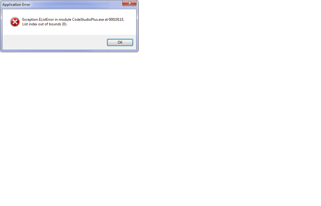

    I have not tried in XP compatible mode, but will try that prior to trying it in a virtual machine. I have tried ADMIN status. Windows is managing my paging file, I have 16G of ram installed, and crashes occur in MCS when I've done a clean boot with very little running. No other apps that I use crash on my system, literally, ever. The error is not a BSOD, it's a program crash error (see below, if I can paste the image properly).
    Name:  error message.png
    Same happens in each of 3 laptops that I've tried this on, so it's not related to video card (which are different), and one was a pristine machine that I had just restored to factory settings. All are DELL.

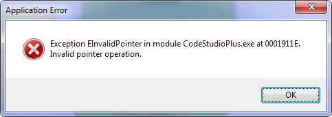

    Compatibility mode for XP results in a crash as well.
    Name:  new error xp mode.png

    The error is the same all the time?
    Seems like a problem with memory address.
    But on a factory state? My suggestion is to try to find what all machines have in common. A driver, a USB chip, something.

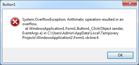

    No. Just when exception is catch, you can get detailed description about it. You can convert it to string, and then display in msgbox with some custom info. Eg I put name of subroutine, etc...
    This is VB .Net code:
    Public Class Form1
        Private Sub Button1_Click(sender As Object, e As EventArgs) Handles Button1.Click
            Dim i As Integer, x As Integer = 1, y As Integer = 0
            Try
                i = x / y
            Catch ex As Exception
                MsgBox(ex.ToString, MsgBoxStyle.Critical, "Button1")
            End Try
        End Sub
    End Class
    Result when I click on button:
    If they add something like this in MCS error should be located.
    Then they can just ignore it, or something, but main goal should be that all work is saved, before it crash.
    Eg they can just put few lines of code to create backup of all open files, to some location. Or to check on start up is there backup, and to ask user what to do, Restore from it, ignore, or what ever.
