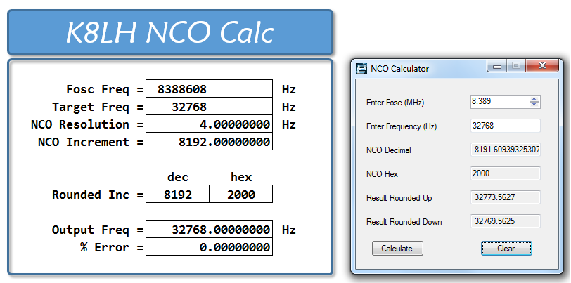

    Using Mr. E-Calc, I wanted to calculate values for a PWM frequency using LFINTOSC, which is 32 kHz. I entered 0.031 where it asks for Fosc (MHz) and wouldn't you know it, IT WORKED! Got me thinking about the NCO Calc. I had limited Fosc to 1 MHz on the low end. This updated Version 1.02 lowered the minimum to 1 kHz (0.001 in the Fosc box).
    Nco Calc1_02.zip

    Hi mpgmike (and gang):
    I like your NCO Calculator app'. Thank you.
    My calculation results are slightly different from those produced by your NCO Calculator. Would you or another forum member have time to help me figure out the problem with my calculations, please?
    I designed a ClockGen IC for a retro 65C02 project a couple years ago using an 8 pin 16F18313 (listing attached below). I used a 32-MHz clock and I used the NCO to generate a 1.8432 MHz clock for an ACIA chip on that project. My NCO calculations were;
    Resolution = 32000000 / 2^20 / 2 = 15.2587890625-Hz
    Phase_Inc = 1843200 / 15.2587890625 = 120795.9552
    Rounding up the phase increment value to 120796 I get the following frequency output;
    Freq_output = 120796 * 15.2587890625 = 1843200.68359375-Hz
    Freq_error = 1843200.68359375 / 1843200 - 1 = ~0.00004%
    Since my phase increment and output frequency values are slightly different than those of the NCO Calculator, I'm wondering if I messed up on my calculations.
    Help appreciated. TIA...

    At the risk of seeming like a troll, may I make a couple suggestions, just in case you ever revisit your NCO Calc program, please?
    (1) Allow entry of NCO Frequencies such as 8388608-Hz without rounding.
    (2) Correct the NCO bit width constant (2097152) in your calculations.
    (3) Display the NCO frequency resolution.
    (4) Display the output frequency error.
    I whipped up a quick spreadsheet to highlight the calculation problems I'm experiencing. Your NCO Calc app' introduces errors by rounding the NCO frequency and by using the incorrect NCO bit width constant in your calculations.
    Have fun. Best wishes. Cheerful regards, Mike, K8LH

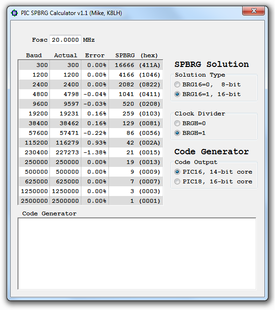

    A spreadsheet is easier to make but I don't think it's easier to use. Mike's stand-alone app' is a seriously cool accomplishment. Personally, I'd rather use a small stand-alone app' instead of a spreadsheet.
    Many years ago I built an SPBRG Calculator spreadsheet followed by an SPBRG Calculator app' written in JustBASIC. I much prefer using the app'.

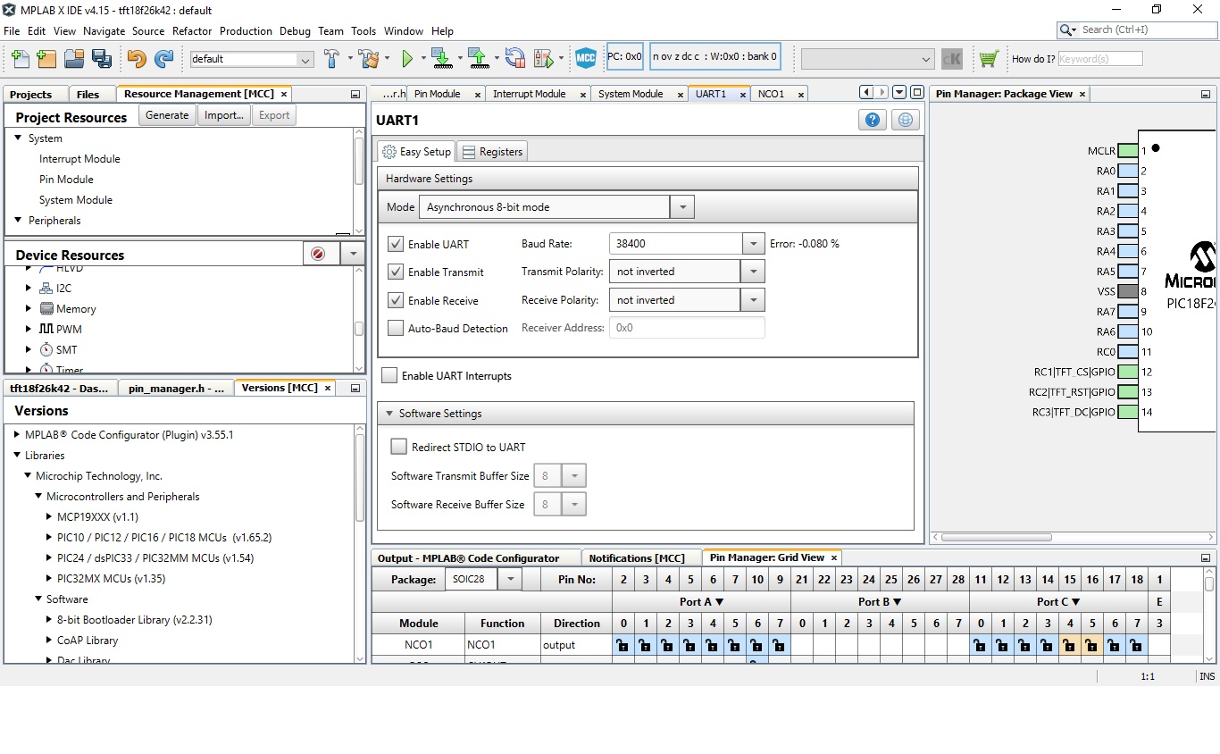

    I forced myself to work with MPLABX over the past few days. I needed a combination of features only found in the PIC16F18426, which is too new for PBP3. I'm building the software in ASM using MPLABX. I like the Debug feature. As I'm not that familiar with ASM, the Debug showed me where I got stuck in an endless loop and helped me catch a few other problems in my code. It's taking me about 10X longer in ASM than it would in PBP3, but I'm learning a bunch through the experience.
