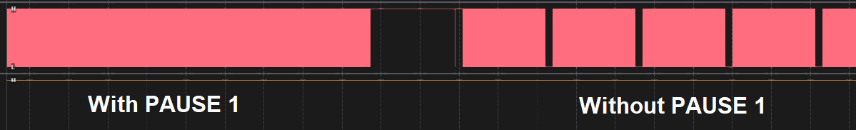

    Any idea why it seems to reset unless I have a PAUSE 1 in Mainloop?
    The trace is on LEDblink pin.
    Name:  Mainloop PAUSE.png
    I had this PIC working a while ago. I don't see what I'm missing.

    What is the duration of this reset, if it is reset?
    You may add a PAUSE 1000 at the beggining of the program and see if this duration is increased. This will confirm that PIC is indeed reseting.

    It is definitely a reset, a look at the lst file shows that the looped code segment has no pbp statements in it that generate a clwdt instruction
    that loop does the the same thing for every pic chip i tried. its not really a practical loop more a curiosity
