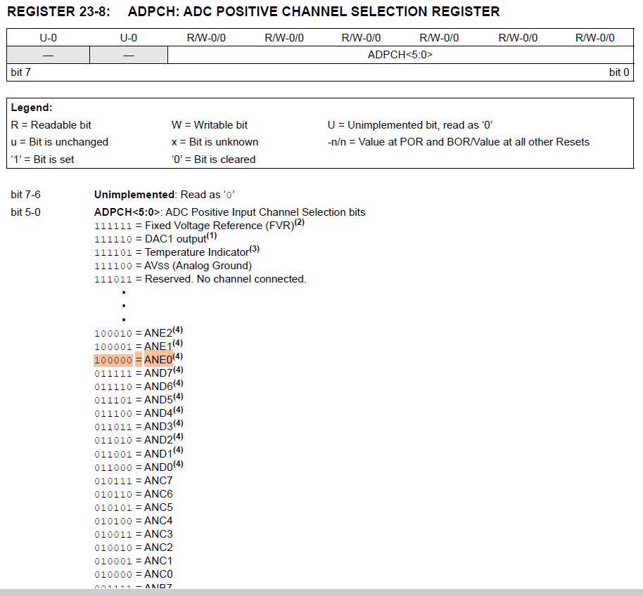

How do you chose ADCIN channel in this case
Results 1 to 5 of 5
    Question How do you chose ADCIN channel in this case
    PIC 16F18877 at 32MHz with FOSC/128 (as per table 23-1 on p. 331) and right-justified results.
    I'd like to use E0:
    Name:  ADCIN channel.png
    HPWM backlight to LCD does work, I see it briefly on start-up using default value.

    ANSELA = %00000000
    ANSELB = %00000000
    ANSELC = %00000000
    ANSELD = %00000000
    ANSELE = %00000001                      ' Pin E0 = ADC input

    I tried several:
    ADCIN 2, ADCinput ' started counting from 0 at E2
    ADCIN 3, ADCinput ' started counting from 1 at E2
    ADCIN 7, ADCinput ' started counting from 0 at the top
    ADCIN 8, ADCinput ' started counting from 1 at the top

    I'd like to use E0:
    why would it not be 32 like it says ? 0b100000 = ANE0
    Default Re: How do you chose ADCIN channel in this case
    Because I'm a potato-head.

    Note to the next guy:
    You don't need the register if there's only the ADC channel inside it (I keep the list only as documentation for the channel numbers).
    'ADPCH = %00000000                   ' ADC POSITIVE CHANNEL SELECTION REGISTER

    You only need to declare the channel in the ADCIN command:
            ADCIN 26, ADCinput
    4,170
    I think this was always the case with the integrated ADCIN command of the PBP.
    Then you can always mess with the registers if your are brave enough!
